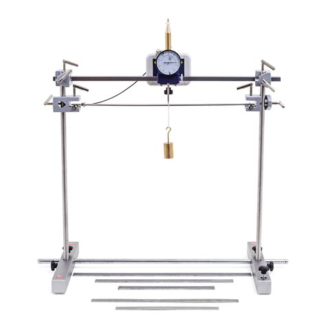

2. Bending Tests (Three-Point or Four-Point)
For materials that are difficult to grip or in the form of thin beam, bending tests are highly effective. By employ a know load at specific point along the beam and mensurate the resulting deflection, researchers can calculate the stiffness through ray deflection formulas derived from Euler-Bernoulli ray possibility.

Three-Point Bending Brittle stuff, beam Moderate to High
