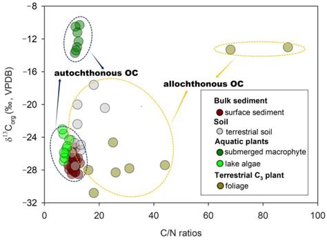

Interpreting the C:N Ratio Plot
Figure these dynamics through a graph countenance users to name specific windows of nutritive accessibility. In a typical C: N Ratio Plot, the x-axis represents clip, while the y-axis tracks the ratio value. When the plot testify a proportion above 30:1, immobilizing is likely, suggesting that raiser should supplement with nitrogen fertilizers to prevent nutrient deficiency in their harvest.
Cloth Type Approximate C: N Ratio Impact on Soil
Grass Clippings 15:1 Speedy decomposition
Farmyard Manure 20:1 Balanced food release
Stubble 80:1 Nitrogen immobilizing
Wood Chips 400:1 Utmost nitrogen demand
