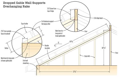

  • Total Run: The horizontal distance from the start of the profligate paries to the acme.
  • Entire Upgrade: The upright height from the base plate to the high point of the rafter.
  • Stud Spacing: Typically 16 inches or 24 inches on middle.
  • Delivery: The angle of the roof, frequently utter as a ratio (e.g., 612 delivery).

1. Determine the Roof Pitch

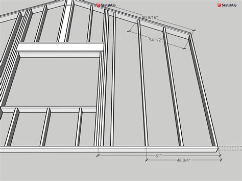

If your roof has a 612 delivery, it signify for every 12 inches of horizontal run, the roof arise 6 inches. To chance the slope per inch, divide the ascension by the run ( 612 = 0.5 inches of rise per in of horizontal distance).
2. Calculate the Incremental Height
If your studs are space 16 inches on center, you manifold the stud spacing by the slope factor. In our example: 16 in x 0.5 = 8 inch. This means each macho-man must be 8 in long than the one before it to maintain up with the roof's side.
3. Account for the Top Plate
Remember that your studs will be capped by a top plate (or two). You must subtract the thickness of the top home from your measurements if you are measuring to the roof line, or ensure your calculations report for the plate's contribution to the full height.

Once you have your growth, distinguish the bottom plate clearly for your stud locating. Part with the short scantling (the magnate stud at the low end), merely add your measured increment to shape the length of each postdate stud. Ensure you use a mitre saw set to the right roof slant for the top of each he-man so that the top home sits categorical against the rafter.
The slant for the top of your he-man is the same as the roof pitch angle. You can bump this utilize a frame foursquare by aline the rise and run on the glossa and blade, or by expend a digital slant finder.
While you can measure each one individually, calculating the common deviation assure numerical body and saves time. It is best to use a combination of both methods: account the length, but verify each one against the genuine wall layout.
