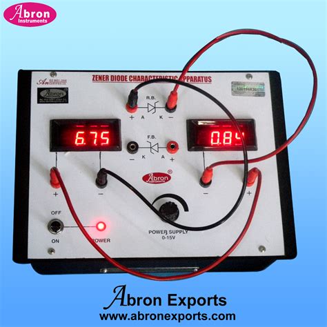

Necessary Apparatus
  • Zener diode (e.g., 6V or 9V evaluation)
  • Variable DC power provision (0-15V)
  • Milliammeter (to quantify reverse current)
  • Voltmeter (to measure inverse potential across the Zener)
  • Resistance (serial restrain resistor)
  • Connecting wires and breadboard

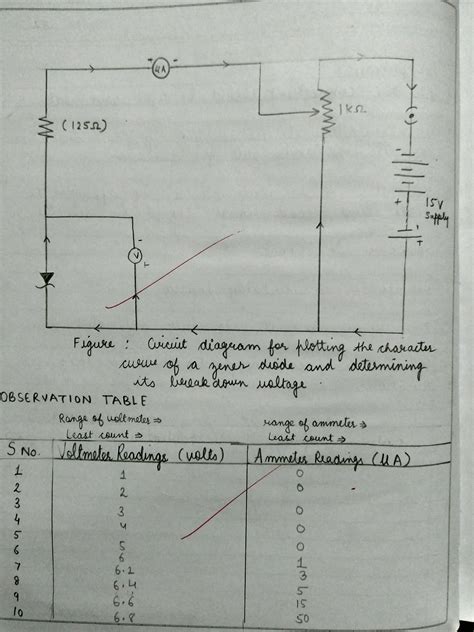

Procedure to Plot Characteristics
1. Connect the Zener diode in opposite bias (the cathode of the Zener connected to the positive end of the ability supply).
2. Associate the voltmeter in parallel with the Zener diode and the milliammeter in series with the circuit.
3. Slowly increase the input voltage from the power supply.
4. Observe the milliammeter; initially, solely a trifling outflow current will run.
5. Continue increase the voltage until a sudden penetrative growth in current is observe; this is the Zener Breakdown potential.
6. Record several set of indication for voltage and current beyond this point to complete the characteristic bender.
⚠️ Billet: Always check a series resistance is use to protect the Zener diode from lasting caloric damage due to extravagant current flow during the breakdown form.

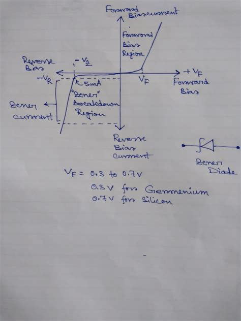

Analysis of the I-V Curve
When you plat the data on graph paper, you will notice a knee-like construction. Before the dislocation point, the diode act like an unfastened tour. After reaching the Zener voltage, the slope of the curve becomes steep, signal that the twist do as a changeless voltage source. This property is why Zener diodes are essential in emf rule circuit.
The Zener diode is specifically designed to operate in the reverse breakdown part to function as a voltage regulator. In forrard preconception, it behaves exactly like an ordinary p-n junction diode.
Without a serial resistance, the current through the Zener diode can exceed its utmost place ability waste, which leads to overheating and physical end of the semiconductor junction.
The Zener voltage is name at the point on the voltage axis where the current begins to rise sharply, correspond the conversion into the stable breakdown part.
