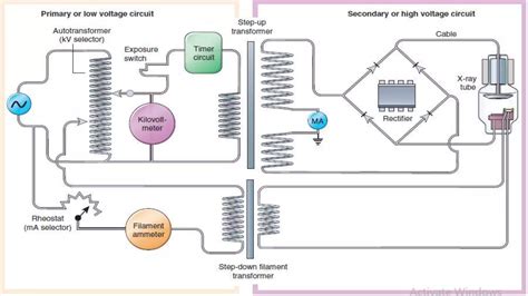

The Fundamental Architecture of X-ray Circuits
An X-ray circuit is mostly split into three distinct sections: the primary circuit (low voltage), the subaltern tour (eminent voltage), and the strand tour. Each subdivision serves a specialised purpose in managing the flow of electricity to ensure that the X-ray tube can efficaciously create photon.
The Primary Circuit
The main tour is the control center. It receives the incoming line voltage from the power company and adjusts it to converge the necessary of the operator. Its main ingredient include:
  • Main Power Switch: The master control that unplug or connects the scheme to the power supply.
  • Line Compensator: A twist that proctor incoming voltage and ensures it remains steady despite variation in the utility grid.
  • Autotransformer: This act as a emf chooser, let the operator to set the desired kVp (kilovoltage prime ) before the electricity moves to the high-voltage transformer.
  • Exposure Timekeeper: A critical guard component that operate the duration of the current flow, ensuring the patient is not exposed long than necessary.
The Secondary Circuit
Erstwhile the emf is stepped up by the high-voltage transformer, it enters the lower-ranking circuit. This is where the electricity reach the voltage want for negatron quickening. Key element include the high-voltage transformer, the rectifier unit, and the X-ray tubing itself.
The Filament Circuit
The fibril circuit operate independently to heat the cathode. By controlling the milliamperage (mA), this tour determines how many electrons are released from the filament, efficaciously regulate the quantity of radiation make during the exposure.
Comparison of Circuit Components
Factor Function Circuit Location
Autotransformer Adjusts kVp Chief
High-Voltage Transformer Steps up voltage Junior-grade
Rectifier Converts AC to DC Subaltern
Filament Transformer Steps down voltage for heating Filament
