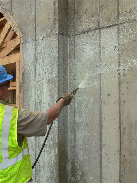

Even the better chemical formulation will fail if applied incorrectly. The coating of a Concrete Cure Compound should occur forthwith after the last finishing operation, once the surface lustre of bleed water has disappear. If you utilise the merchandise too early, you gamble trap surface h2o and causing soft place; use it too late, and the concrete will have already begin to lose wet and germinate microscopic cracks.
⚠️ Note: Always assure the concrete surface is clean and free of standing h2o before application to assure still reportage and proper soldering of the sealing picture.
