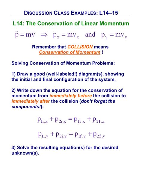

To grasp the signification of this preservation law, one must first understand what one-dimensional impulse represents. Mathematically, impulse (refer by p ) is the product of an object's mass (m ) and its velocity (v ). The formula is expressed as p = mv. Because velocity is a vector quantity - meaning it has both magnitude and direction - momentum is also a vector.
The principle of preservation province that in a shut system, where no outside strength (like clash or gravity) act upon the aim involved, the total momentum before an event equals the total impulse after the case. This apply regardless of whether the objects jar, push off each other, or separate.
The Mathematical Foundation

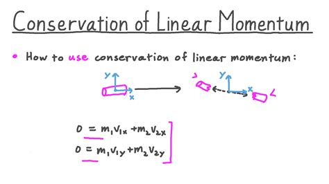

The Conservation Of Linear Momentum Formula is write as follows:

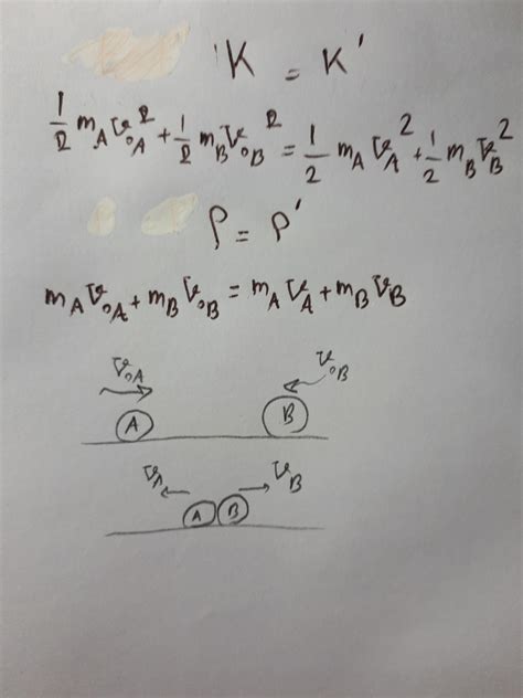

Σ p initial = Σ p final
Or, in a more expanded pattern for two objects interacting:
m 1 v1i + m 2 v2i = m 1 v1f + m 2 v2f
  • m 1, m 2: The masses of the two objects.
  • v 1i, v 2i: The initial velocities of the aim before the interaction.
  • v 1f, v 2f: The final velocities of the object after the interaction.

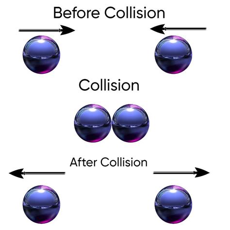

Types of Collisions in Physics
Hit are classified based on the behaviour of kinetic energy during the interaction. While momentum is incessantly maintain in a closed system, energising energy may be lost to go, heat, or deformation.
Collision Eccentric Momentum Conserved? Kinetic Energy Conserved?
Elastic Yes Yes
Inelastic Yes No
Perfectly Inelastic Yes No (object stick together)
Elastic Collisions
In an idealistic elastic hit, the objects bounce off each other without any lasting distortion or thermal zip loss. While truly pliable hit are rare in the macroscopic world, subatomic particles often behave this way.
Inelastic Collisions
Most unremarkable hit, such as a ball hitting the flooring or two railcar crashing, are inelastic. Some kinetic energy is converted into other signifier of energy. In a "perfectly inelastic" collision, the object lodge together and go with a mutual net velocity, which significantly simplify the calculation employ the Conservation Of Linear Momentum Formula.
