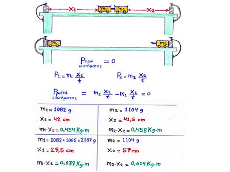

  1. Level the air path to ensure that gravity does not quicken the gliders during the collision.
  2. Measure the heap of each glider using the electronic balance and platter the value.
  3. Position the photogates at deliberate separation to capture the speed before and after the encroachment.
  4. Loose the sailplane to jar, ensuring that no external forces interfere with the process.
  5. Double the trials multiple times to gather a sufficient dataset for statistical analysis and error checking.

Once the velocities are recorded, estimate the impulse for each body. The full scheme momentum before the hit should be liken to the full impulse after the hit. In a Conservation Of Linear Momentum Practical, you will likely bump slender discrepancies do by data-based fault.
