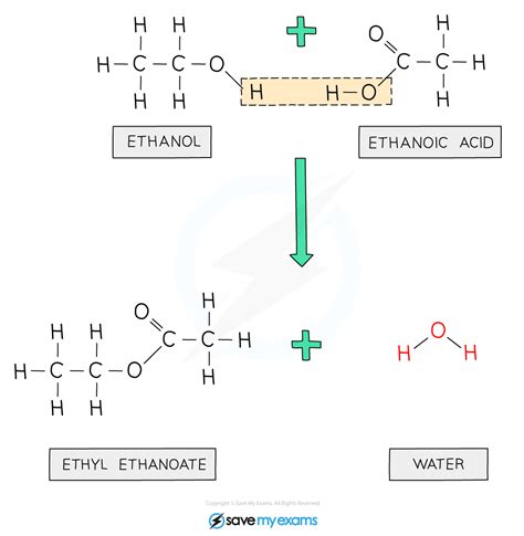

At its nucleus, the production of ethyl acetate involves a Fisher esterification. The reaction is an equilibrium-controlled summons, entail that the forward reaction - the formation of the ester - competes incessantly with the half-witted response of hydrolysis. To motor the reaction toward the desired product, practitioners must apply principles of chemical thermodynamics and kinetics.
Chemical Mechanism and Catalysis
The operation typically utilizes a potent acid catalyst, such as sulfuric acid or solid-state ion-exchange rosin, to protonate the carbonyl oxygen of the acetic acid. This increases the electrophilicity of the carboxyl carbon, facilitating a nucleophilic attack by the ethanol atom. Postdate the elimination of h2o, the ethyl acetate ester is organise.

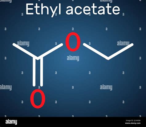

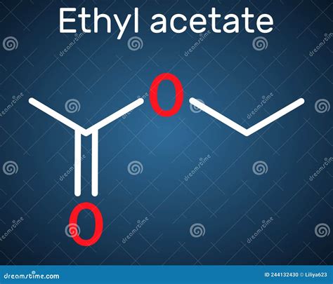

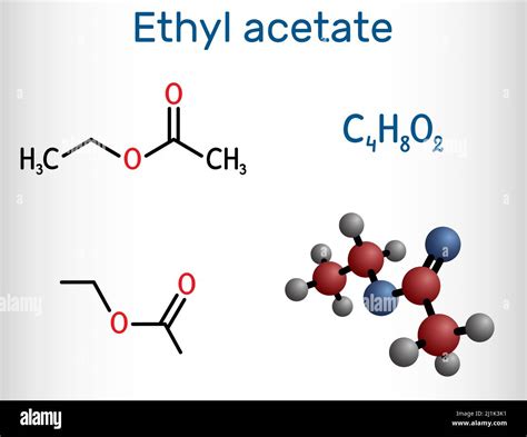

  • Reactants: Acetic Acid (CH₃COOH) and Ethanol (C₂H₅OH)
  • Product: Ethyl Acetate (CH₃COOC₂H₅) and Water (H₂O)

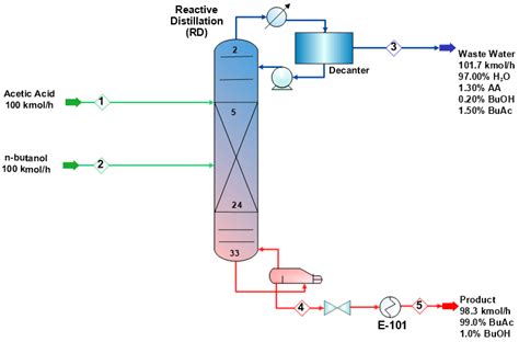

Reactive Distillation
Modern industrial flora often utilize reactive distillation to compound the response and separation stairs into a single column. In this configuration, the esterification occurs concurrently with the distillation operation. As the ethyl acetate is formed, it is removed from the response zone along with water via an azeotrope, preventing the reverse reaction from occurring.
