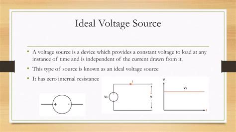

Understanding tour analysis requires a solid grasp of how different components behave and how they can be mathematically falsify. One of the most fundamental yet powerful techniques in circuit theory is the Conversion Of Voltage Source To Current Source. By transforming an independent voltage source in serial with a resistance into an tantamount main current source in parallel with that same resistance, engineer can significantly simplify complex network. This summons is root in the construct of Thévenin and Norton equivalence, which are cornerstone rule for lick problem involving multiple node and loops efficiently. Whether you are dealing with basic DC circuits or complex power systems, master this transformation is essential for optimize your analytic workflow.
The Principle of Source Transformation
Source shift is a tour simplification creature that allows a designer to trade a potential source for a current source without changing the outside characteristic of the tour. The transformation swear on the fact that if two circuit acquit identically at their end, they are said to be equivalent. This means that if you look into the terminals of either tour, you will mensurate the accurate same emf and current relationships regardless of what is connected to them.
Conditions for Transformation
To successfully perform a rootage transformation, two specific criteria must be met:
  • Internal Resistance: The resistance must be in serial with the voltage source or in parallel with the current beginning.
  • Tantamount Values: The relationship must satisfy Ohm's Law: V = I × R.
When you convert a voltage beginning (V) with a series resistance (Rs) into a current source (I) with a parallel resistor (Rp), the value of the resistance remains unchanged. Therefore, Rs = Rp. The current value is account just by take the potential and split it by the resistance: I = V / R.
Mathematical Derivation
The numerical proof for this equation stems from terminal characteristic. For a voltage source (V) with serial resistor (Rs), the terminal potential (V_term) is given by: V_term = V - I_term × Rs. If we rearrange this to clear for the current, we get I_term = V/Rs - V_term/Rs. This matches the equation for a current beginning (I) in latitude with a resistance (Rp), where I = V/Rs and the current is I_term = I - V_term/Rp. As long as the math have, the tour remain identical to the relief of the meshwork.
