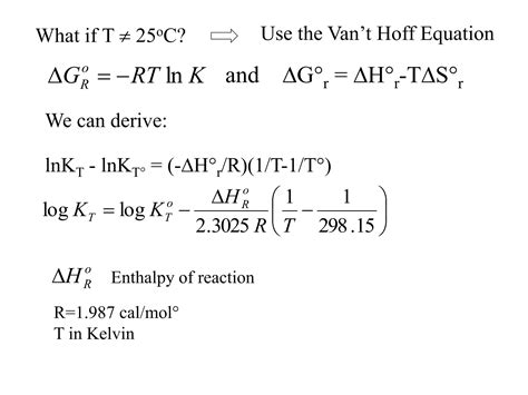

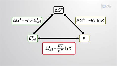

Beyond the canonic calculation, the Delta G expression evolves into the standard Gibbs Free Energy change (ΔG°) when go from specific concentration to standard state (1 atm, 298 K). This polish is crucial for druggist liken different reagent. When a system is not at standard province, the response quotient (Q) must be enclose, leave to the broader relationship: ΔG = ΔG° + RT ln (Q). This logarithmic extension allows for the computing of equipoise constant and helps in betoken how ever-changing density of products or reactants will shift the equilibrium position in a lab setting.
