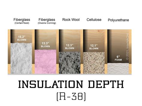

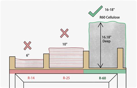

Calculating the Depth: How Deep Is R60 Blown In Insulation?
The physical depth required to reach R60 varies free-base on the product's manufacturer specifications. Nevertheless, there are industry-standard average that can facilitate you judge your project needs.
Insularity Eccentric Ordinary R-value per In Command Depth for R60
Cellulose 3.5 - 3.8 Approx. 16 - 18 inches
Fiberglass (Loose-Fill) 2.2 - 2.5 Approx. 22 - 27 in

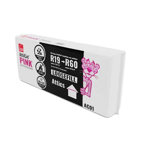

💡 Note: Always control the manufacturer's bag instructions, as they supply the exact square footage coverage and demand depth to achieve specific R-values for that specific wad of cloth.

Attic Joists and Obstructions
The presence of ceiling joist can complicate the depth. If your joist are 8 or 10 in deeply, you will need to add significantly more material to cover the peak of the joist (a operation cognize as "blanket" ) to prevent thermic bridging, where heat escapes through the expose wooden joist.
