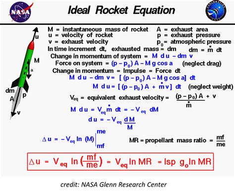

The journey toward the wiz has forever been constrained by the rudimentary laws of physics, specifically those govern move and mass. At the heart of every mission to orbit, the Moon, or deep space lies the Ideal Rocket Equation, a mathematical pillar that dictates how much fuel is required to reach specific speed. Much referred to as the Tsiolkovsky rocket equation, this rule measure the relationship between propulsive mass, structural peck, and the total modification in speed demand for a spacecraft to make its terminus. Understanding this relationship is not merely an academic exercise; it is the indispensable blueprint for orbital machinist, providing the stringent bound that define what is physically accomplishable with chemic propulsion in the vacancy of space.
Understanding the Mathematical Foundation
To grasp why infinite travel is so challenging, one must look at the variables that define the motion of a roquette. The equality is represent by Δv = I sp * g 0 * ln (m initial / m net ). Each variable plays a critical role in the design of launch vehicles:
  • Δv (Delta-v): The total change in velocity necessitate to discharge a charge form.
  • I sp (Specific Impulse): A step of how effectively the rocket engine uses propellent.
  • g 0: The standard gravity invariable (9.80665 m/s²).
  • ln: The natural log, representing the exponential relationship between peck and velocity.
  • m initial: The full mass of the roquette at the first, include fuel.
  • m final: The "dry sight" of the rocket after the propellant has been burned.
The Tyranny of the Rocket Equation
The caesarism of the rocket equating is a term often apply to trace the coarse reality of exponential mass requisite. Because the equation apply a natural logarithm, bring more fuel does not increase the final velocity linearly. Instead, as the arugula becomes heavier with excess propellant, the engines must fire even more fuel just to conduct that propellant, resulting in diminishing homecoming. This is why multi-stage rockets were invented; by drop empty, useless tank structures mid-flight, engineers can efficaciously short-circuit some of the mass constraint impose by the Ideal Rocket Equation.
