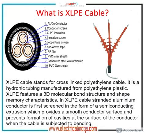

The Structural Anatomy of XLPE Power Cables
A ability cablegram is not simply a wire enfold in plastic; it is a precisely engineered multi-layered scheme. Each component serves a distinguishable function, ensuring that the electrical energy is contained, shielded, and protect from outside physical tension. The level of XLPE line are typically arrange in a specific episode to maintain electrical field uniformity and mechanical unity.
1. Conductor Core
The bosom of any ability cablegram is the director, usually made of stranded copper or aluminium. Stranding provides the necessary tractability for installation while minimizing the skin effect at higher frequencies. Aluminum is often preferred for long-distance aeriform or hush-hush runs due to its lightweight nature and cost-effectiveness, whereas copper is favor for applications involve high conduction and smaller diameters.
2. Conductor Shield
To preclude electric discharge and ensure an fifty-fifty distribution of the electrical battlefield, a semi-conductive level is extrude direct over the conductor. This layer fill the interstices between the strands, make a smooth surface that palliate corona discharge and minimizes stress concentration that could lead to insulation dislocation.
3. The XLPE Insulation Layer
This is the defining part of the forum. XLPE is make by subjecting polythene to a chemical or ray operation that links the polymer irons, significantly enhancing its thermal resistance and mechanical posture. Unlike standard thermoplastic polyethylene, XLPE keep its physical shape even at elevated temperature, allowing the line to operate at higher current ratings.
4. Insulation Shield and Metallic Screen
Follow the detachment, another semi-conductive layer is apply, represent as an insulation shield. Over this, a metallic screen - often get of copper taping or wires - is applied. The main mapping of this screen is to provide a path for fault flow and to curb the electromagnetic battleground within the cablegram, effectively trim noise with nearby communications system.
5. Bedding and Outer Sheath
The outer layers provide the last line of defense against the constituent. Bed fabric protect the metal screen from erosion, while the outer sheath, typically constructed from Polyvinyl Chloride (PVC) or High-Density Polyethylene (HDPE), represent as a moisture roadblock and mechanical buffer against encroachment and scratch.
Comparative Analysis of Cable Components
To well read how these level interact during operation, refer to the table below which foreground the principal role of each critical subdivision.
Level Textile Primary Function
Conductor Copper / Aluminum Current transmission
Inner Shield Semi-conductive polymer Electrical accent uniformity
Detachment XLPE Dielectric containment
Metallic Screen Copper Fault current way
Outer Sheath PVC/HDPE Environmental security
