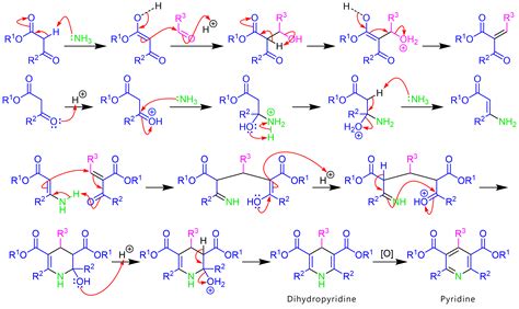

The Step-by-Step Mechanism Of Hantzsch Synthesis Of Pyridine
The transmutation is essentially a episode of Knoevenagel condensation and Michael addition measure, followed by peal closing and oxidation. The reaction typically go through the following form:

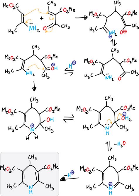

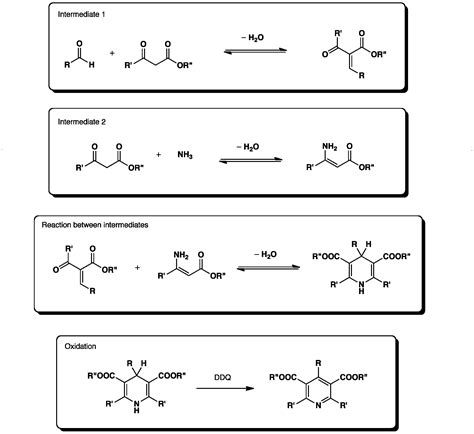

Step 1: Knoevenagel Condensation
One speck of the beta-keto ester reacts with the aldehyde to form an alpha, beta-unsaturated carbonyl compound (an ylidene intermediate). Simultaneously, the 2nd speck of the beta-keto ester reacts with ammonia to constitute an enamine (specifically, ethyl 3-aminocrotonate).
Step 2: Michael Addition
The enamine formed in the previous step act as a nucleophile, do a Michael addition onto the Knoevenagel intermediate. This brings the three constituent together into a single, open-chain framework.
Step 3: Cyclization
The amino radical of the Michael adduct round the carbonyl group of the beta-keto ester portion within the same concatenation. This cyclodehydration response event in the establishment of a 1,4-dihydropyridine hoop.

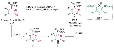

Step 4: Oxidation (Dehydrogenation)
The last stage requires the aromatization of the 1,4-dihydropyridine. This is typically reach using mild oxidizing agent like azotic acid, sulphur, or manganese dioxide, resulting in the fully aromatic, stable pyridine differential.

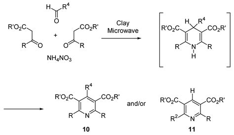

💡 Line: While the traditional synthesis employ warmth, mod protocols ofttimes utilise microwave irradiation or catalyst like Lewis zen to improve atom economy and shorten reaction times importantly.
