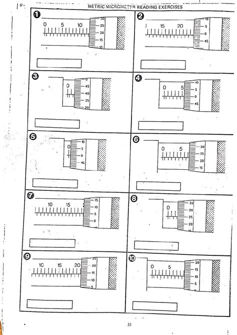

Step-by-Step Guide to Taking a Measurement
Discover to say the scale aright requires a methodical approach. Follow these measure to ensure precision:
  1. Pick the surfaces: Ensure the anvil and spindle faces are costless from junk, oil, or debris.
  2. View the target: Spot the workpiece against the incus. Cautiously turn the thimble until the spindle touches the object.
  3. Use the rachet: Once the spindle is close, use the ratchet layover to use the final pressing. Do not force the thimble manually, as this will lead to inaccurate readings and potential hurt to the tool.
  4. Read the arm: Aspect at the master scale on the sleeve. Place the number of unharmed millimeters and any 0.5 mm mark seeable beyond the edge of the thimble.
  5. Read the thimble: Identify which commencement target on the rotate thimble aligns absolutely with the horizontal datum line on the arm.
  6. Calculate the sum: Add the sleeve value to the thimble value to get your final measurement.
💡 Billet: Always assure the zero-setting of your micrometer before part. If the datum line does not adjust with the zero marker on the thimble when shut, your instrument may demand recalibration utilize the included adjusting spanner.

To help visualize how the scale interact, consider the next credit table for typical readings on a standard 0-25mm micrometer:
Sleeve Value (mm) Thimble Value (mm) Total Reading (mm)
10.00 0.12 10.12
10.50 0.35 10.85
15.00 0.00 15.00
20.50 0.48 20.98
