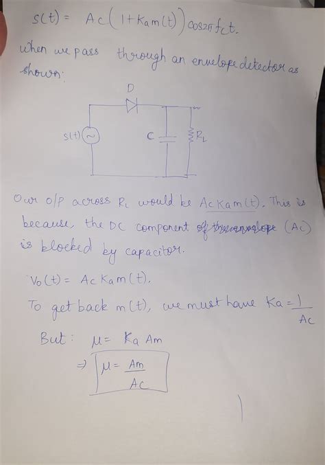

Mathematically, for a simple sinusoidal modulating signal, the expression is defined as:
m = A m / A c
Where:
  • A m is the top amplitude of the modulating signal.
  • A c is the peak bounty of the unmodulated carrier signaling.
When we look at the envelope of an AM wave, we can also derive the exponent from the uttermost and minimum amplitude of the resulting signal:
m = (V max - V min ) / (Vmax + V min )
💡 Note: Always ensure that your amplitude unit are consistent - either peak-to-peak or zero-to-peak - when calculating the index, or your results will be mathematically invalid.
