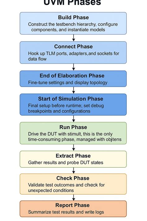

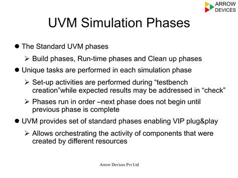

Understanding the Core UVM Simulation Flow
The UVM lifecycle is broadly separate into three independent categories: build form, run-time stage, and cleansing form. Each phase serves a specific purpose in the lifecycle of a verification component. While the build phases occur during the refinement degree before clip zero, the run-time phases grapple the literal input generation and signal action.
The Build and Connect Phases
The build process is the foundation of any UVM testbench. It is where the component hierarchy is build and connecter are found.
  • build_phase: This is where the testbench hierarchy is instantiated. Components call create () to build their children.
  • connect_phase: Used to connect TLM embrasure and exportation. It ensures that the communication substructure is ready before any traffic flows.
  • end_of_elaboration_phase: A final assay before model starts, ofttimes utilize for debugging or print the topology.

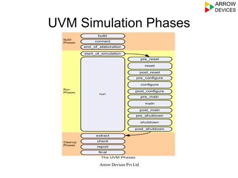

The Run-Time Phases
Formerly the model start at time zero, the run-time phases take over. These are task-based form, import they can have model time, unlike the function-based build form.
Phase Name Eccentric Principal Purpose
reset_phase Undertaking Apply and remove resets
configure_phase Chore Program internal register
main_phase Task Primary stimulant generation
shutdown_phase Task Allow concluding transactions to drain
πŸ’‘ Note: While these identify run-time phases exist, many see engineers prefer use succession actuate within the run_phase for o.k. control over stimulus synchronization.

Cleanup and Reporting
Once the main_phase completes, the testbench transition into the cleanup stage. This is crucial for verify that the DUT reached a stable province and for sum execution metrics.
  • extract_phase: Retrieves data from monitors or scoreboard to figure last reporting or fault counts.
  • check_phase: Validates final resultant, such as check that all expected transactions were treat by the scoreboard.
  • report_phase: Summarizes simulation results and mark information to the log file.
Function-based phases (like body-build) can not have model time and must stop now, whereas task-based phases (like master) countenance the use of holdup and events.
The build_phase is destine only for instantiation. The connect_phase guarantees that all components in the intact hierarchy exist before you try to link their ports together.
Yes, you only need to implement the methods for the phases that your specific component command; UVM will merely cut the phases that are not defined.
