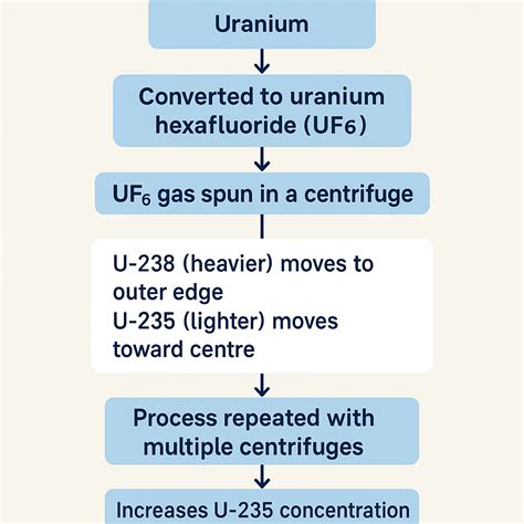

Before the physical separation can begin, solid yellowcake (uranium oxide) must be converted into a chemical form suitable for processing. The industry standard is Uranium Hexafluoride (UF6). This compound is take because it sublimate into a gas at relatively low temperatures, allow the isotope to be manipulated use fluid dynamics and centrifugal strength.
Primary Methods of Enrichment
Over the decades, respective technology have been developed to isolate U-235 from U-238. While early effort bank on monolithic dissemination plants, modern facility favor more efficient mechanical methods.
Gas Centrifuge Process
The gas separator is presently the most dominant technology in the industry. In this method, gaseous UF6 is fed into high-speed rotors. Because U-238 is slightly heavier than U-235, the centrifugal strength force the U-238 toward the outer walls of the cylinder, while the lighter U-235 corset closer to the center. This enrich gas is then siphoned off and moved to the succeeding centrifuge for farther concentration.
