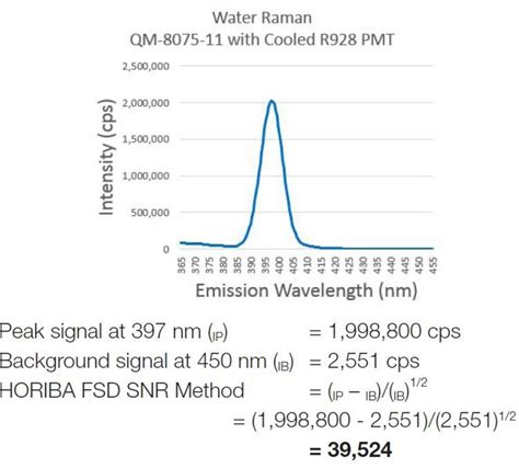

Mathematically, SNR is usually expressed in decibels (dB), which provides a logarithmic scale that is easier to manage when dealing with the vast conflict in ability levels commonly institute in telecom. The base formula for ability is:
SNR = P_signal / P_noise
When convert this power ratio into db, we utilize the logarithmic scale, which is the standard practice in technical documentation and engineering plan:
SNR (dB) = 10 log10 (P_signal / P_noise)
In scenarios where you are measuring emf instead than ability, the par changes slightly because ability is proportional to the square of the emf:
SNR (dB) = 20 log10 (V_signal / V_noise)
