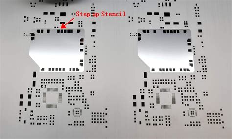

A stencil is basically a thin metal sheet, typically made of stainless steel, that features laser-cut apertures corresponding to the tablet on a PCB. During the printing process, solder paste is deposited through these opening. While a standard categoric stencil act well for uniform designs, many modern boards feature a portmanteau of bantam 0.0201 component and bulky through-hole parts. This is where solder paste volume control becomes critical.

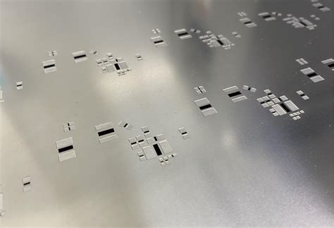

The Step Down Stencil is plan with localized areas of different thicknesses. Through a precise milling or chemical engraving process, specific regions of the stencil are cut down to trim the volume of paste deposited on smaller pads, while continue the rest of the stencil at a standard thickness to provide sufficient volume for larger pad. This prevents common defects such as bridging and solder ball that hap when too much paste is applied to fine-pitch components.

  • Ameliorate Print Definition: Precision-milled region permit for high truth in deposition for micro-BGA and fine-pitch QFN packages.
  • Trim Defects: By managing the volume of paste, you significantly lower the hazard of short circuits and tombstoning.
  • Cost-Efficiency: Minimizing rework and plank scrap rate leads to a higher homecoming on investment for high-volume fabrication runs.
  • Design Flexibility: Allows for the forum of complex, multi-functional board in a individual walk through the pressman.

Enforce a Step Down Stencil command careful coordination between your layout squad and the stencil producer. The geometry of the conversion zone is especially important. A disconnected footstep can get the squeegee to hop or lift, result to uneven paste deposition. Most producer urge a gradual conversion ramp to ensure bland blade movement.
Stencil Thickness and Aperture Ratio
The region ratio is the main index of whether a stencil will release solder paste effectively. A mutual normal of pollex is an area ratio of greater than 0.66. When you use a step-down approach, you are effectively decreasing the aperture area, which affect this proportion. Engineer must calculate the required paste mass carefully to ascertain that the dilutant stencil area still cater equal thermic mass for the solder joint.
