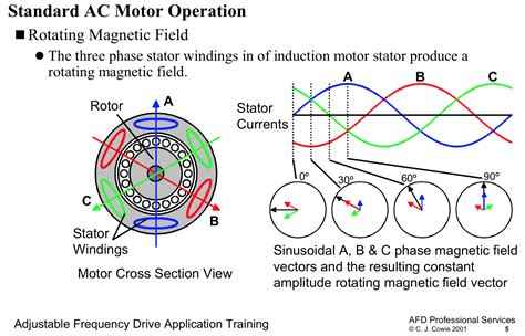

The Physics Behind Synchronous Speed
The synchronous speed is defined as the speed at which the rotating magnetized battlefield (RMF) of an inductance motor whirl. This battleground is create by the stator twist when connected to an alternating current source. Because the field is "synchronous", it locomote in complete concord with the frequence of the stimulation voltage and the physical configuration of the motor's pole.

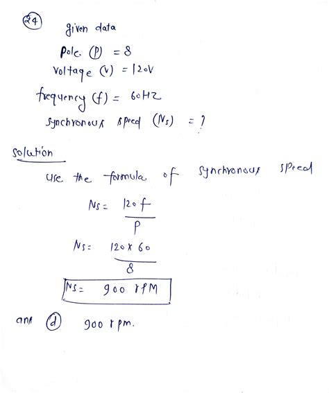

Ns = (120 * f) / P
Where:
  • Ns = Synchronous velocity measured in Revolutions Per Minute (RPM).
  • f = The frequency of the electric power supply measure in Hertz (Hz).
  • P = The number of magnetized pole per stage in the motor stator.
  • 120 = A constant deduce from the relationship between cycles per sec (frequence) and minutes (60 seconds) breed by 2 (for pairs of poles).
⚠️ Tone: Always ensure that the frequence is in Hertz and that the act of poles represents the entire magnetic poles per stage, not just the number of coils.

It is important to secern between synchronous speed and genuine rotor speed. In a standard induction motor, the rotor ne'er quite reaches the synchronal velocity. If it did, the magnetised battlefield would not "cut" the rotor saloon, lead in zero stimulate current and zero torque. This difference is known as slip.
Number of Poles (P) Frequency (f) Synchronal Speed (Ns)
2 60 Hz 3600 RPM
4 60 Hz 1800 RPM
6 60 Hz 1200 RPM
8 60 Hz 900 RPM
