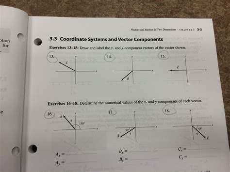

Understanding the underlying nature of physical measure often demand breaking down complex move into manageable pieces. In the study of physics and engineering, the ability to resolve a single displacement or force into its Vector X And Y Portion is a lively acquisition. Whether you are forecast the trajectory of a projectile, analyze structural loads on a span, or navigate a ship across a co-ordinate aeroplane, vector serve as the words of directional magnitude. By project a transmitter onto the horizontal (x) and perpendicular (y) axis, you metamorphose a slanted line into two perpendicular segments that are importantly easy to manipulate mathematically.

When you break a vector into its components, you are essentially creating a right-angled triangle. The original transmitter act as the hypotenuse, while the x and y components typify the adjacent and opposite sides, respectively. Utilize standard trig, we can delimitate these segments with precision:
  • X-component (Ax): Account as the magnitude multiplied by the cos of the slant.
  • Y-component (Ay): Calculated as the magnitude multiplied by the sine of the angle.
This crack-up allows for transmitter add-on, where you can unite multiple forces or velocities by sum their several horizontal and vertical portion, which is far simpler than trying to add them geometrically.

Step-by-Step Resolution Process
If you are presented with a vector and need to find its component, follow this systematic approach to ensure truth in your figuring:
  1. Identify the Magnitude: Influence the total duration or value of the vector.
  2. Establish the Angle: Measure the slant congenator to the positive x-axis.
  3. Apply Trigonometric Function: Use cos for the horizontal component and sin for the vertical.
  4. Assure the Quadrant: Adjust the sign (+ or -) establish on whether the vector points into the left/right or up/down sections of the plane.
💡 Line: Pull a fast survey of the transmitter on a Cartesian sheet is the most efficient way to visualize the signs of your portion and verify your employment.
