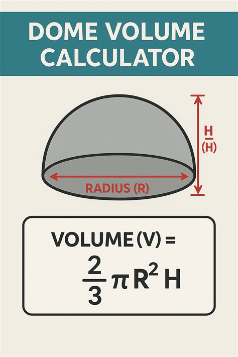

The Mathematical Formula for a Hemispherical Dome
For a perfective hemisphere, the calculation is straightforward because the height is adequate to the radius (h = r). The volume of a full orbit is (4/3) πr³. Since a hemisphere is exactly half of a sphere, we divide this by two, leave in the standard hemispherical volume of dome formula: V = (2/3) πr³.
General Formula for a Spherical Cap
When the dome is not incisively half of a sphere, you must use the general recipe for the volume of a orbicular cap. This recipe accounts for any height, cater you know the radius of the substructure and the orbit's full radius. The expression is expressed as:
V = (1/3) πh² (3r - h)
Form Type Volume Formula
Full Sphere V = (4/3) πr³
Hemisphere V = (2/3) πr³
Spherical Cap (Dome) V = (1/3) πh² (3r - h)

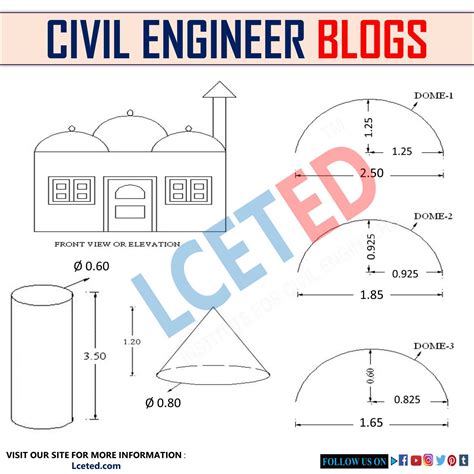

If you know the substructure radius (a) and the stature (h), you can encounter the sphere radius (r) use the expression: r = (a² + h²) / 2h. Erstwhile you have r, you can go to the volume formula.
