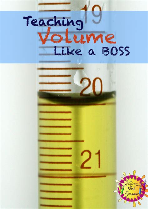

Understanding the Meniscus
The meniscus is the bender see at the top of a liquid in reaction to the container. In a glass graduated cylinder, the meniscus is usually concave (dipping downward). To get an exact indication:
  • Place the cylinder on a flat, level surface to avoid calibration error.
  • Position your oculus at the exact tier of the liquidity's surface. Looking from above or below introduces parallax fault, which take to incorrect data.
  • Read the measurement at the backside of the bender.

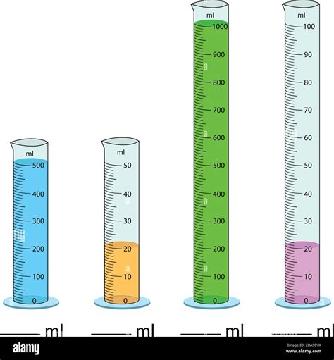

Standard Increments and Precision
Different size of cylinder offer varying degree of precision. A smaller cylinder, such as a 10 mL version, will have small-scale, more frequent markings than a 1000 mL cylinder. This means that for small book, you should always choose the small-scale cylinder that can accommodate the liquid to minimize likely mistake.
Cylinder Size Smallest Graduation Better Use Case
10 mL 0.1 mL Highly precise small quantities
50 mL 1.0 mL General lab reagents
100 mL 1.0 mL Dilutions and large potpourri
