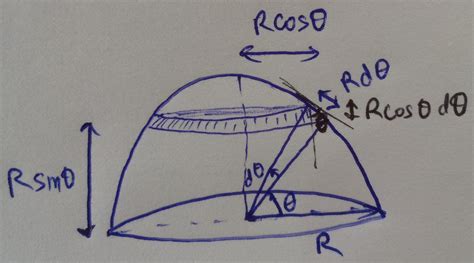

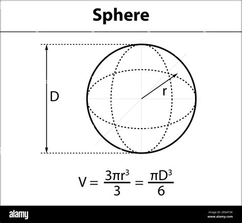

To figure the book of a hollow hemisphere, we must firstly think the recipe for a solid orbit and then gain the hemispherical counterpart. A full sphere has a volume given by V = (4/3) πr³. Since a hemisphere is exactly one-half of a sphere, its bulk is estimate as:
  • Bulk of a solid hemisphere = (2/3) πr³
The Concept of the Hollow Interior
A hole hemisphere implies a structure with a certain thickness. It is defined by two radius: the outer radius ( R ) and the inner radius (r ). The space between these two surfaces constitutes the actual material volume of the shell, while the inner volume represents the capacity or empty space within the bowl. The formula to find the volume of the material (the shell itself) is:
V = (2/3) π (R³ - r³)
