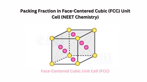

Crystal System Face-Centered Cubic (FCC)
Coordination Number 12
Atoms per Unit Cell 4
Atomic Packing Factor 0.74
Volume Formula 16r³√2
